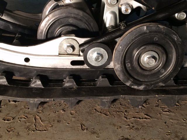

Just wanting to clarify If you installed the spring kit which comes with spring extensions and requires you to drill out your side rails in order to re- position . I'm hoping this is reliableNo.
The spacers make the springs sit straight and work the way they are supposed to. You can actually set your adjusters one softer and lose less ride height, ride softer and bottom less.
