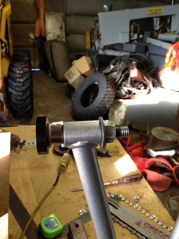

I had some more measurements somewhere from when I made my tool to install them but haven't found them yet.
Here's a link to a picture of the tool I made on the lathe.
http://www.ty4stroke.com/attachments/img_0146-jpg.94669/
It made installing them a breeze. Still had to press in the lowered but it acted as a guide and they went in nice and straight.
