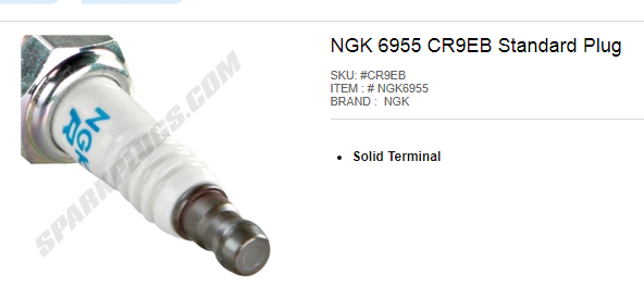

Just wondering what oil people are using in Apex’s. Manual says 0-30 but a lot of people are running 0W-40. I also have four NGK Cr9E spark plugs but the sled calls for CR9EB can I use just the CR9E

The difference between the NGK CR9E and EB is the terminal end that the coil attaches to. The CR9E has a threaded terminal while the "B" has the solid terminal "Bullet" tip that the Apex coils use.

The difference between the NGK Cr9E and Cr9EB is the terminal end that the coil attaches to. The Cr9E has a threaded terminal while the "B" has the solid terminal bullet tip that the Apex coils use.
