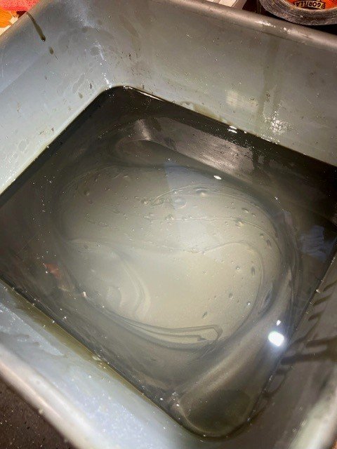

quick back story- bought a 2020 winder in October, off the original owners wife (he passed) the condition of the sled (extremely nice) the home and property to match, could only think it was well maintained and taken care of.
sled sat for a season or two ( inside) i get it home and rip the whole sled apart to fully service and check everything, when i changed the oil it had a metallic shimmer to it that you could swirl with your finger, not what i wanted to see but i bought a used sled is what it is... changed it and moved on
just got back from 1500 kms of riding in northern Ontario, sled ran perfect zero issues.
figured i would change the oil again to see what it looked like, and sure enough still has a metallic shimmer, no chunks or flakes or any debris you can feel with your finger, cut the filter open its also free of any debris. what ever is in the oil does seem to settle and the oil looks normal until you run your finger through it - i do have an oil analysis bottle coming to send it out to get checked,
it does how ever smell like gas and it does seem thin compared to fresh yamalube, im not ignoring the fact that it looks to me like this engine probably has to come apart to check bearing's and internals, but i would like to do some more digging before i tear it all apart, the oil level was slightly higher then i set it to at the last service, how could that much fuel get into the oil? leaking injector? i would think the sled would have a running issue if it had a leaking injector or two? only signs of smoke out of exhaust is black snow under the exhaust after idling in the same spot for a few min, which comparing to a couple turbo vipers i ride with seems normal. any advice is appreciated

I see this a lot on newer low mile engines. The engine is fine. No reason to take the engine apart. Myself I absolutely won’t use Yamaha engine oil after seeing this more often than not. Use a good quality oil like Mobile 1 ESP 0/30, Quaker State full synthetic 5/30, or Pennzoil synthetic. When engines are nearer you will see more glitter. It gets better over time.
Also, if you don’t grab a sample mid stream as it comes out of the oil tank, the data is worthless. Taking oil samples from the drain pan is not the way to do it. How many miles on sled? Does it use any coolant?
I agree with KnappAttack as well.
If it is NOT LOSING ANTI FREEZE...I would put in some inexpensive oil, run the sled for a short warm up, drain the oil again, change the filter, remove and clean the oil tank and oil lines. When reassembling the oil tank be very fussy sealing it back up to the chain case cover. The BOP oil tank gasket works well. Install a new filter and high quality oil.
When doing all this its a good time to inspect and service your chaincase as well.
If you haven't done the roll over valve bypass its a good time to that as well.
You had stated you just completed 1500 kms trouble free....so I wouldn't think there is anything major wrong with it...so I would definitely keep it simple initially hoping for a solution before jumping into major surgery.

You do mention "the oil level was slightly higher then i set it to at the last service" so this is something to pay close attention to.quick back story- bought a 2020 winder in October, off the original owners wife (he passed) the condition of the sled (extremely nice) the home and property to match, could only think it was well maintained and taken care of.
thanks
Connor
Oil level should never increase. Along with this is, as you mention, also pay close attention to coolant level. Should not have "top off" coolant in the overflow tank.

Dont underestimate how long it takes to get these engines up to temp - to the point where they begin burning off moisture collected in the oil system due to condensation.
Was in northern Quebec once on a reasonably cold day (-15C), in the am after start up and running for 30 min up a rail line (which you would think the sled would be plenty hot) - i looked where i have the oil tank vent tube which i have discharge in the footwell area - was blowing puffs of moisture out even after that much time had passed.

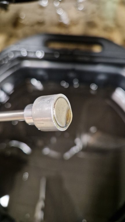

After noticing the oil looked grey/shimmery, I decided to go through the system more carefully. First I drained the oil from the tank and filled it with fresh oil. I then ran the sled for about 20 minutes and drained it again. The oil looked pretty much the same as before.
After that I did a more thorough drain:
- drained the oil tank
- drained the bottom of the engine
- removed the oil from the hoses going to the oil tank
I checked the oil with a magnet as well and there was no metal on the magnet either.
Because of that I’m leaning toward this being condensation/emulsified oil rather than metal contamination, probably from short runs and the cold climate.
I’ve now installed a new oil filter and fresh oil, so I’ll run it again and see how it looks after a proper ride!

crazy to me how moisture in the oil can look like bearing material... my brain thinks too much i need to turn it off lol. i have yet to drain mine again but i only have put a couple hundred kms on since doing the triple flush lol.Yes, that makes sense, and I think that might actually have been what I was seeing.
I also opened the oil filter to inspect the filter media and there was no metal in the filter at all.
