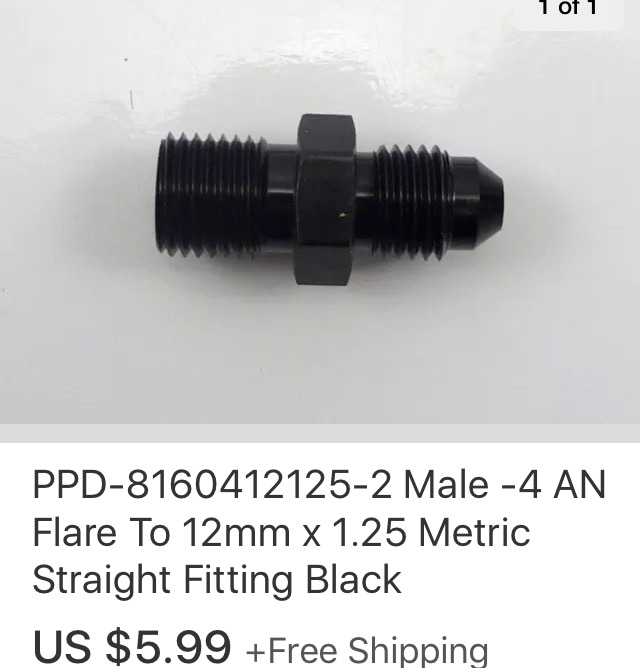

I have a hydraulic hose place close by but I need to know the oil drain specs so I can get that fitting out of the engine.

I'm pretty sure the fitting on the bottom is a 12mm
Pstn head
I beilieve its 14mm

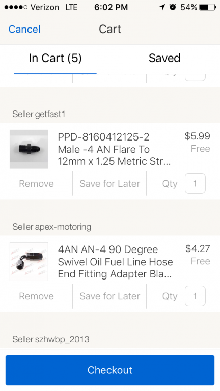

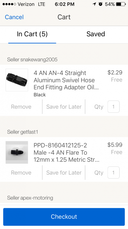

All for less then $20

Wow.....Must be more manufacturers than b4 making for a more price competitive situation.
#4 is very small diameter line. No biggie.
I found a topic like yours. Google "viper oil drain" comes back to TY forum topic couple years old.
Definitely worth doing.
Use electric tape or like on hose ends. That and a shot of lube to put ends on. Will go alot smoother than nothing at all.

View attachment 133431 I used #6 an fittings, $22 on ebay.
