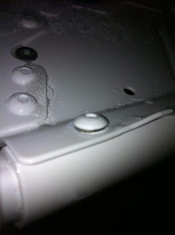

Is it a big deal to get it cleaned out of there right away? I did ride 120 miles before I noticed it. (This was on my 4 day back pack trip). Now I'm home and we have enough snow to ride but I'm so busy with work there will only be time to rip the sled and airbox apart and clean it all up now or go ride. The sled will also need to make another trip to the dealer, the gas gauge doesn't work anymore and there is a super loose rivot in the tunnel I can move it up and down and spin it all around. Pretty disappointing I was trying to keep tunnel looking good. I have never seen a rivot go loose like this before and the sled only has 1300 miles on it.
No not a big deal. Most has probably drained out of your bellypan already. Sorry to hear about your other issues. Is it the rivet at back of running board that holds support in? Guage will be wire at sending unit.
Alright thanks, I will just leave it for now and clean it up once our snow melts. My loose rivot is right on the side rail where the foot section attaches to that round section of the tunnel.
