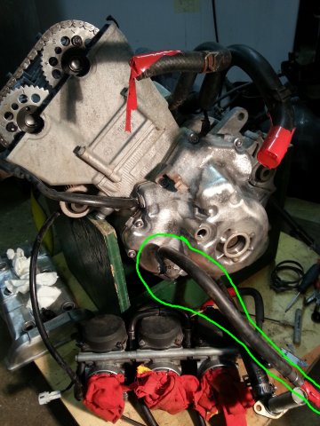

theres 2 nipples coming off the breather box, one is a big one, and on the very very bottom facing the bellypan theres a smaller diameter (1/2"ish) nipple, on the same side as the oil resevoir look down and to your left behind the brake disc, youll see a hose that is attached to the engine block and it will be just laying down in the bottom, get a flashlight youll see it.

heres the only pic i could find, but this is the hose you need attached to the bottom. notice the spring clip on the end, its a real bitch to get on, you have to hold the breatherbox up while its out of the carb boots, stretch the hell out of the hose to get it to attach to the nipple. Make sure that the engine area is warmed up prior to doing this, if you try stretching a cold hose your gonna rip it

he said theres no hose on the bottom of his breather box, there definitely needs to be one there

Everything was bone dry around the oil reservoir & around the oil filter. I haven't had a chance yet to look for the hose in the pic you posted J1635. If it's down there, it's not under the brake disc. It must be behind the frame that's behind the chain case. It'll be fun to get to it.
There's actually 3 nipples on my air box. One on each side of the back of the air box & the subject one at the front RH bottom. It's the only one that faces down & drains the bottom of the box. I still don't understand how the air box should be drained into the crank. There's sure to be water contamination mixed with the oil.
