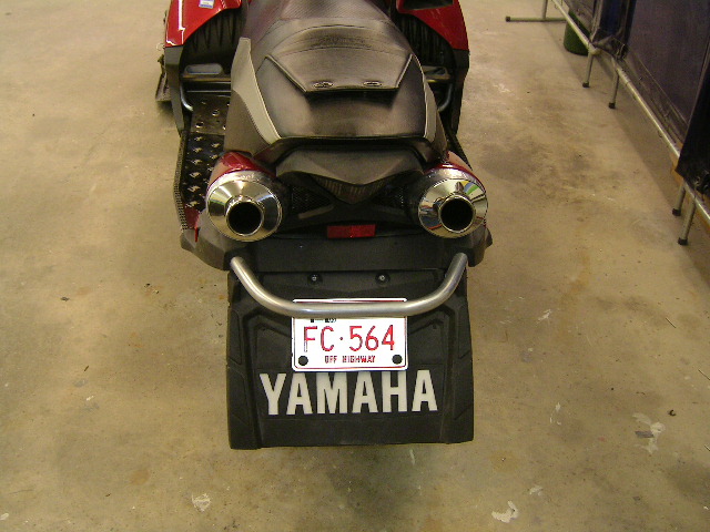

here is a list of whats on this machine guys, 2871 turbo , large powderlites intercooler, rb3 management- fuel and timing, meth injection,headshim and precise cam timing, 2.25 double down pipe turning out under tunnel into 2 ,2inch pipes exiting via pair of hindle mufflers in stock location, the 2.25 inch pipe was kept to the shortest possible length to aid restriction,clutched using HRP quad cam primary running 4 super tips at 91grams secondary stock using 53-45 dalton helix with A/C green spring, gearing is 26-38 perfect fit and chain angles in the case, the turbo sits on a true 4 tube header wich is a minimum of 17 inches in tube length, turb is placed forward and higher than a CPR, air intake protrudes through the hood for high pressure cold air, This sled has been a joy to dial in using the rb3 its simple and spot on makes almost anyguy a efi tuner. I have pounded the heck out of this now for 200 miles and I can honestly say it makes my other turbo sleds feel slow, the 2871 with the rb3 has very very little lag but the midrange is insane using an eboost to control boost is precise boost all the time, this machine has run 131 mph in 4 inches of snow on the gun on hard ice I feel it would probably into the 140s or until the track says good-bye, it is a machine to treat respectful it is to much for trail riding and the weak point now for me is belts cant seem to hold them in the secondary I know why but I am going to turn the boost down to be safe. One more note this engine has stock rods in it with 3000 miles I have pushed it to 24 lbs and that is rediculouse to ride with, I have made it to my quest wich was a killer tyrail machine, Thanks Dave and Dave couldnt have done it without your help, I will post a pic of the radar gun when I get my best #s.

Is it possible to see pics of the exhaust under the tunnel?
