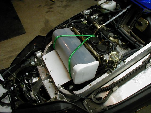

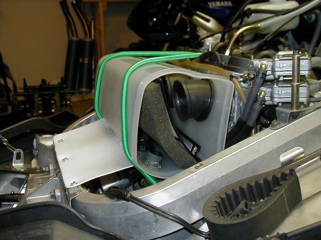

Well, I got the float bowl updates done. Seems to run fine. Also got Kachess' airbox on. You really can tell a weight difference in the boxes, and it's just so much cleaner looking. Now I can finally reach right down to my filter! I still have to figure out what to do around the back of the seat with the new exhaust.

Thatspec
Stock airbox weighs 7.xx pounds, I would say you save 4-5 with that thing. Is the white flap absolutely necessary?
I rolled my sled into a tree well a few weeks back where it sat upside down for ten minutes, then on its right side for another 35 minutes, and NO oil entered the airbox. A few days ago I rolled onto the left side first, then immediately rolled it all the way over to get it unstuck, there was a 1/2 cup of oil in the stock airbox. Makes sense to look at it, keep it off the left side. How well will this box keep oil away from the carbs, any different? Does the foam filter have a reasonable seal?
AaronBND
Mark, not sure about the oil issue. It should be the same as the stock airbox. I wasn't sure I would like it, but it has really grown on me since the install. It's clean, and feels nice and sturdy on there. The white snow flap is probably the way to go since the stock box came over the top of the inlet. The hood vents would sit right there above it. Just cheap insurance I guess!
