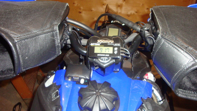

Looks like you can order them on Amazon. These are the same ones by the looks?This is what Ulmer used to carry. I have them on two sleds for over ten years, no problems. Check with him.View attachment 156999 View attachment 157000

Looks like the same, but if I remember right (Allen) Ulmer provided you with the appropriate T fitting that goes into the heater line by the thermostat? for your sled, I don't know how readily those are available from other places. Still might save you some time to check with him first and see what he has available or left over. He also had exact installation instructions with pictures for each model sled.

I sent ulmer racing a email about the gauge just waiting to hear back.Looks like the same, but if I remember right (Allen) Ulmer provided you with the appropriate T fitting that goes into the heater line by the thermostat? for your sled, I don't know how readily those are available from other places. Still might save you some time to check with him first and see what he has available or left over. He also had exact installation instructions with pictures for each model sled.

Not running a trial tank but purchased a used mtx exchanger that I'm going to install and also change out the antifreeze. Gonna add a daytona temp sensor so I can get a better idea of actual engine temp. If I still have issues I'll go ahead and replace temp sensor and thermostat.Cant remember Logan if you said you were running a Trail Tank? I had read about cooling issues with Trail Tanks before I installed mine. The Trail Tank reduces the area behind the radiator and its efficiency for cooling. So when I installed my Trail Tank I looked at going with either the MTX cooler or BOP dual cooling fan kit. In the end I went with BOP fan kit for the reason if you are running on a hard pack or ice, there will be little to throw against the MTX heat exchanger. That and the fan kit was a lot less money and super easy install. I also added some Amsoil Dominator coolant booster for an added measure. So far I have not had any cooling issues in over 3,000 miles I put on my Nytro in the last two seasons with this setup. G.B. https://www.amsoil.com/p/dominator-coolant-boost-rdcb/
