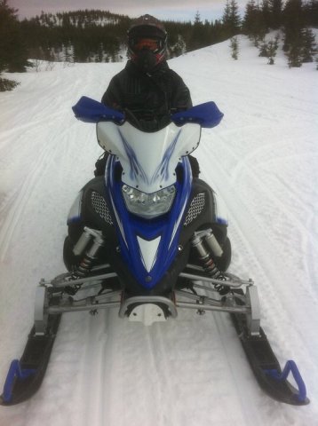

The sign company I worked actually printed the color on white vinyl. So I picked the colors out of their color charts and picked a Yamaha blue for one windy and black for another. So as the vinyl was applied to the outside, the back side of the windy is white. I was even able to apply Yamaha stickers on the vinyl to complete the look.
The vinyl was trimmed on the windy with a knive. So if you get your face really close to it, you can see clear windy in spots up against the black edge trim. However, once it is mounted on the sled, you cannot tell or see any gaps up against the trim.

Any pics gone blue? I would like to paint/vinyl the windshield in the picture the same as the blue se windshield.
