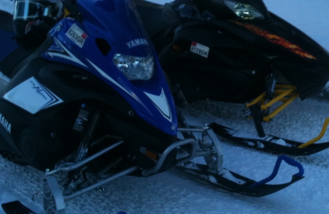

The right side graphic on my 07 RTX (flames) began to peel off and I need to replace it. I like to keep the stock graphics if I can. A replacement is expensive for such a small sticker...WTF
Anyone have any suggestions?
