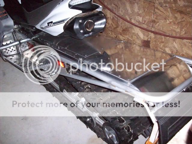

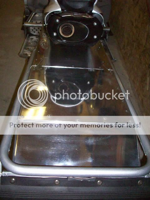

nightsniper
here's mine, havent had any problems.

JohnnyHollywood
I used some diamond plate aluminum from Tractor Supply. Only had to cut 1/4" off of one edge and she fit like a glove!
