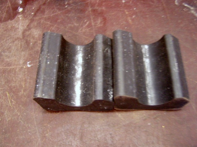

I bought these and used the rubbers and new bushings. The kit cost $34.
The rubbers do fit rite in but I ended up cutting out the plastic tabs that stick up in the skis to get the rubbers to sit flat. After that it was a very easy install. I think with skis, slydog mounts and carbides I have $325 into the Pilots. I have pictures of the install, but don't have then with me to post right now. If anyone is interested, let me know and I can post them later.

I got pics

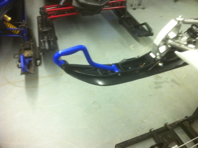

I just used the OEM rubbers when I installed the 6.9s. Also modded the stock blue yamie handles to fit pilots.
Dan
