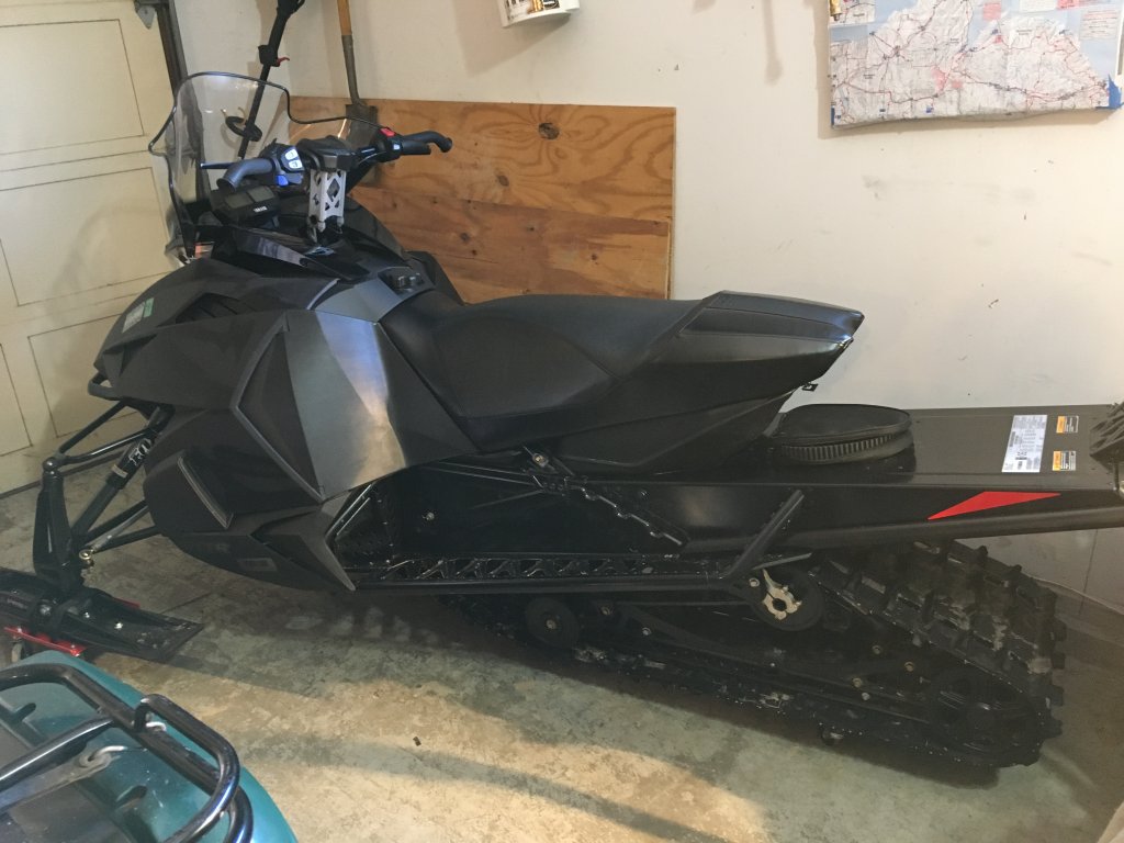

I found a pic of my buddy's Viper, this "was" a Red/Black/White LTX, I think it looks bad #*$&@ like this.
Looks great in pics. Did ya just mask off stickers and spray away
That looks great! The black and orange combo looks really mean and clean.
It looks like your sick day on Monday paid off. :)
Is that a new Storm 150 track I see mounted up on your sled?
Yup, masked off the stickers and gave it 3 coats of Plasti-dip. I actually bought some plastic dye from a company named Parasol to dye the panels. I dipped first to make sure I liked it, that way i can peel it off and dye it if i want.
That is the new Storm 150. That track looks better in person !!! i cant wait to get that thing on the snow..
