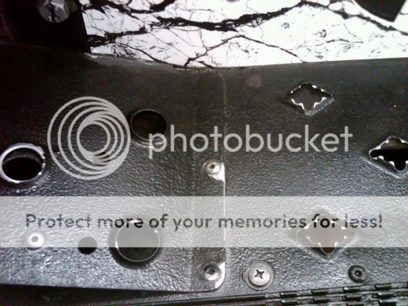

Bedliner right out of a spray can:
2 years 1000 miles later

What kinda prep work did u have to do to do this? How far did u have the sled torn down?
BigShow29
I took the seat off and the plastic in the back.. I already had all the front plastic off from another project..
All I did was wash the tunnel.. The good thing about plasti dip is that it is removable.. So no real prep(sanding,primer) It holds up real well but can be pealed off..
It has lasted on my rims for a few 1K miles now.. Pressure washed a few times..So Ithink it will last on the tunnel for awhile..
You dont really have to tape anything off...With enough pressure you can rub it off or with a razor start it peeling.. I taped just for less clean up...
You can watch you tube videos of people using it and taking it off....
