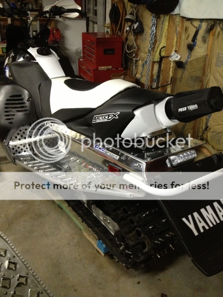

Mothers Billet (by hand) works great!

Apex2006 said:Mothers Billet (by hand) works great!
Wow.!!!!!! That looks exactly how i want mine to look... Looks great!!
