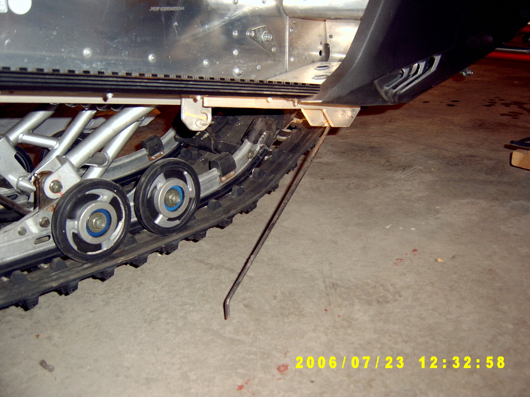

I guess this is probably a stupid question, but what are those scratchers for?
RX1-er-2005
For lube when snow gets hard or ice surfaces it creates a spray of snow to cool slides and rads, it works great, custom made you can't buy these of the shelf.
