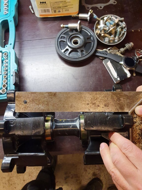

I think this is the root cause. The drivers are not straight. This may cause the track to "stick" on the drivers and crerate a loop that wears the railtips down.....
View attachment 152898 View attachment 152899
Yeah, I could definitely see how that would cause the track to hang up on the drivers and cause the loop effect. Basically with the driver's that badly worn and not straight, it effectively puts them out of time with each other as well.

Yes, I always use the ice scratchers when i'm not in the pow. I have a pair of brp scratches that I will mount as well.
The torque arm is straight, as far as I can measure (cross measure, etc).
The sled has Maptun 270 hp kit and it might be to much for the drivers.
However, I order new drivers, rails, tips, anti stab axle, slides, etc. I can tell you, these things aren't cheep here in Sweden
