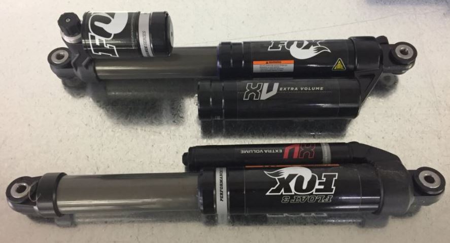

Unfortunately, that 2016 will most likely have the smaller Fox Float (one on the bottom in the pic) that many complained about in '16 and 17' to where Yamaha upgraded to the larger Fox Float shock and offered it to just '17 Apex owners (shafted the Vector owners) as a free upgrade:
- 7,960
- 2,091
i managed to get one for my 16 under warenty in 2020 as the sled was a nos when i bought it and was at dealer for its 1st oil change but was told it was the last one they where covering at the time.Unfortunately, that 2016 will most likely have the smaller Fox Float (one on the bottom in the pic) that many complained about in '16 and 17' to where Yamaha upgraded to the larger Fox Float shock and offered it to just '17 Apex owners (shafted the Vector owners) as a free upgrade:
i weigh 250 lb but have short legs so i am always towards the front of the seat and the oe springs (at least in canada) where too stiff for me.
loving the 1.5" composit on my 11. just waiting for the ripsaw to die on my 16 before i up grade it to a similar track.
sry cannot see facebook ads at work but i would not be scared of anything under 10000 mi that looks decent.
