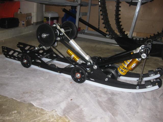

Here are some plates to reinforce those rails so it will never bend.

berge75 said:Here are some plates to reinforce those rails so it will never bend.
Berge75,
Nice job on the reinforcements. I was going to do the same, ended up with the iceage rails. Are they aluminum? Did you make them?

berge75
LeeKo said:berge75 said:Here are some plates to reinforce those rails so it will never bend.
Berge75,
I had these cut out at a local shop that has a water jet. I used 6061 aluminum. These bolt on in a few minutes with just the plasic spacer being cut down 1/4 inch. Mach3 saved this design on his compuer,so he can cut more of them at any time.
I ride this sled hard and did not want to take a chance on buckling the stock plates and recking the rails. Cheap insurance
