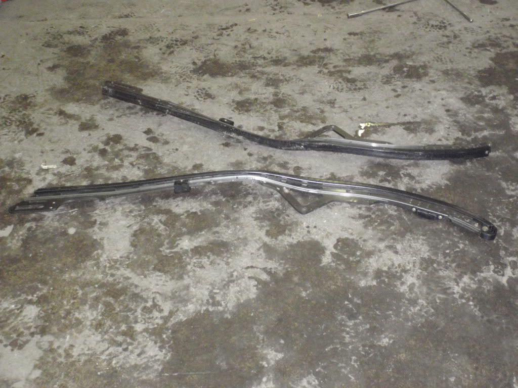

I have stabbed a couple tracks, it sucks. Here is some pictures of a un common track stabbing. I couldn't figure out what happened, I over jumped a road but it was not that hard of a landing, it folded up my rails like nothing.
It wasn't until a few weeks later that I found out what actually happened. Mr. Moto told me he had seen a couple stabbings that folded up the rails like this. That in combination with missing a rail cap and some track clips, it finally made sense.
Cheap insurance to run one
