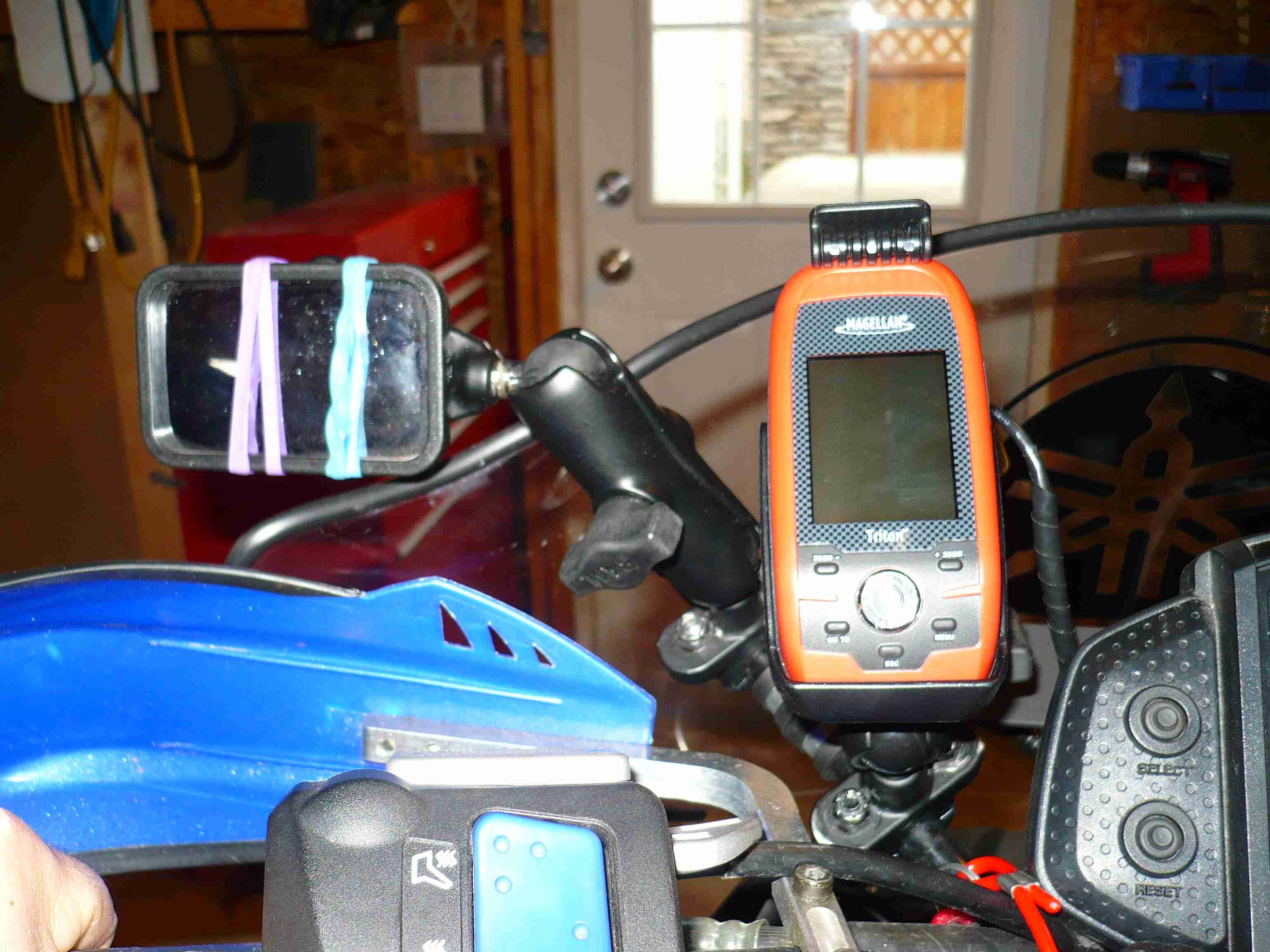

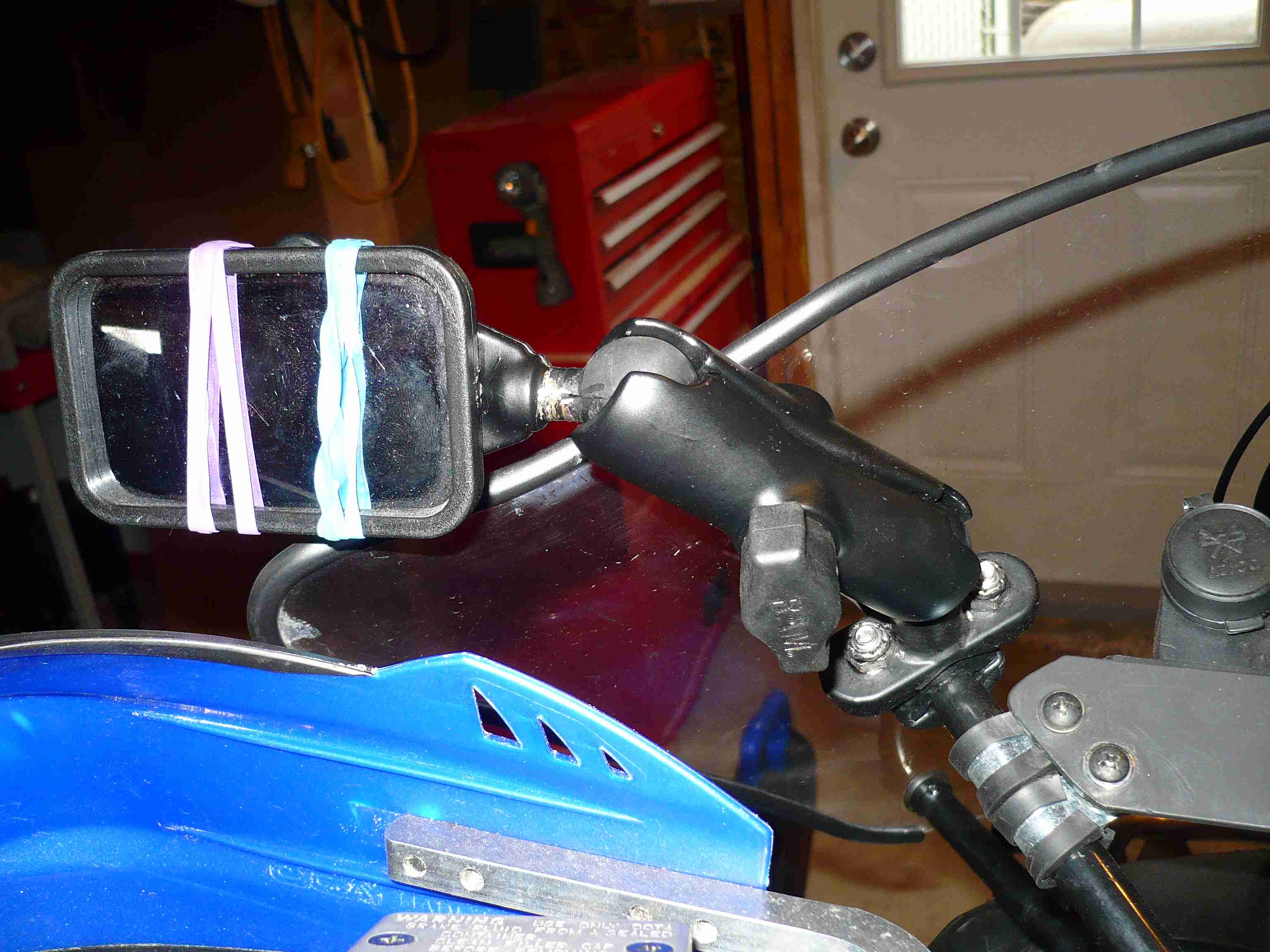

I wanted to mount a mirror on my Phazer just for checking if a sled is behind me. But didn't want anything permanent or that would stick up and interfere with the cover.

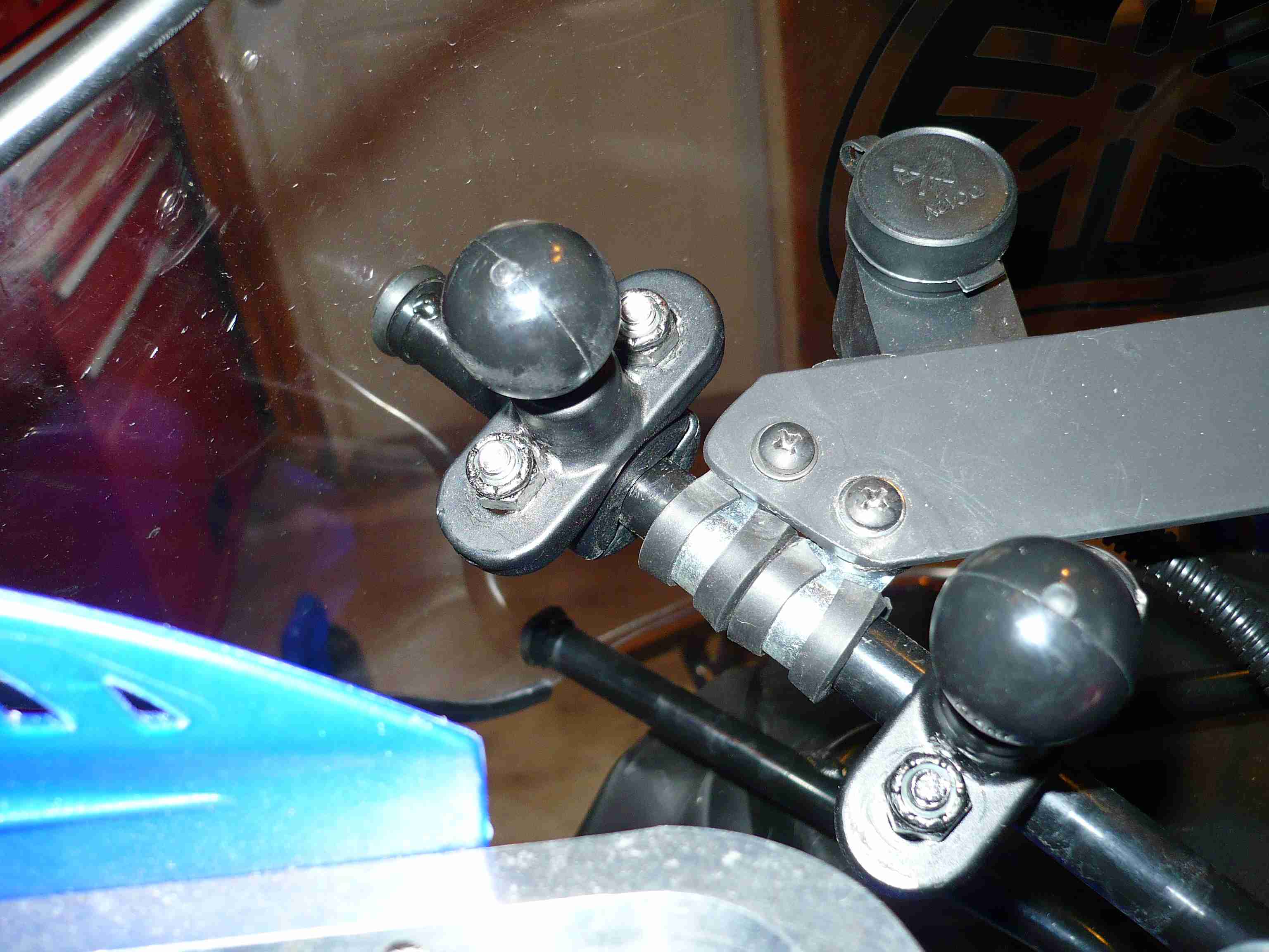

I had some RAM Mount parts kicking around so I glued a mirror to a RAM mount bracket which attaches to the windshield mount. Its fully adjustable and I can remove it if needed.
The elastics are there to hold the mirror while the glues dries.

I use a Permatex adhesive that's incredibly strong. http://www.permatex.com/products/Automo ... ealant.htm
Its holding my car GPS to another RAM bracket without any problems.
If I was looking for new handguards I would go with the PowerMadd ones and install their mirrors. But I didn't want those. As I mentioned this cost me nothing as I already had the parts plus its easy to remove.
