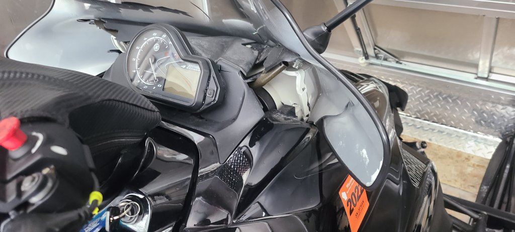

Well I am pretty sound is normal, ended up buy a 2016 Viper RTX DX, and it has the same noise, but riding yesterday wife rolled the Rage but she is ok so that's all that important, came down a steep hill to a right 90 degree corner that was all spun off and was ice, it busted windshield and mirror and speedo plastic, hopefully I can find parts

Well that certainly sucks, but you are right, important thing is your wife wasn't seriously hurt. You never know what trail conditions are like, so it's very important to have an ice ripper track or have it studded to help prevent such surprises on the trail or icy roads. Fortunately, your instrument cluster wasn't damaged, but still going to cost you a few hundred dollars to replace all that broken dash plastic from Yamaha., but buy yourself an after market windshield. Some dash plastics can be purchased after market as well.
- 7,698
x2. same windsheild mask and dash as an rx1. kimpex makes them aftermarket.
