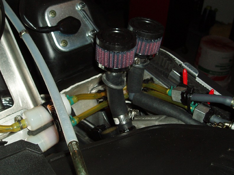

hey citizens,
here are pictures of my 05 warior, used a cocktail mix of infomation from this great site and good old American enginuity. i chose to vent both sides of motor, than have to drain water from evac. the sound the filter kit makes is awesome!!!! i start the sled every few days just to here it roar. like all the rest of you i can't wait for it to snow.

hey citizens,

TMSSP05,
What did you use to replace the valve cover plug? I think I like this better than the EVAC that connects back into the filters.
I recall Freddie having good things to say about the EVAC kit into the filters and that it made more power. I wonder how this one will "stack" up (no pun intended).
