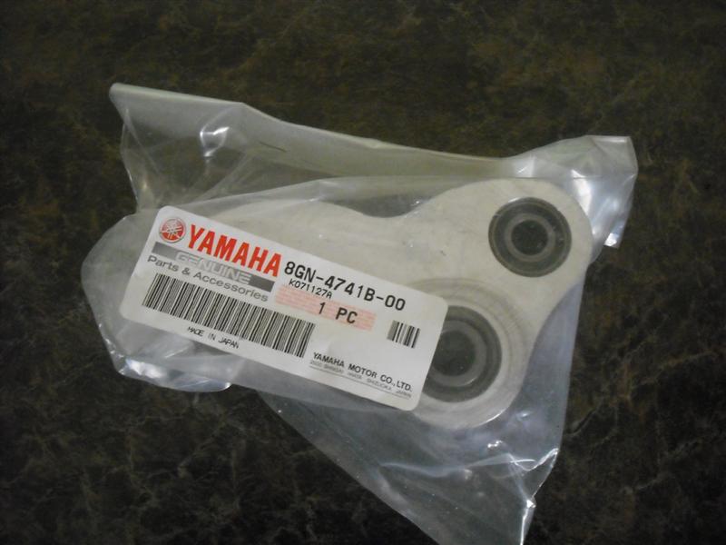

I'm doing a job I hate. Replacing the a arm bushings. I spent an hour removing one nut from one of the long bolts. It was froze on, and I had to drill the nut to weaken it, then used vise grips on it.
My question now is what do I use to remove the old bushings? I know one of you creative guys has a good method.
See pic. Ulmer posted this earlier, use the new bushing to knock out the old, flange of the bearing is now opposite of original but is fine.

I use a DEEP SOCKET in the buik head, get just the right size and drive them out and in the arms use your long bolts SHOULDER from the arms and tap them out...
I also shimed the FRONT to BACK slack with home made VINYL SIDING washers and what a DIFFERENCE it makes, no more SLOPE...but what a pain to fit them in, patience...patience...and more patience! but worth the effort.

Thanks guys. Putting them in from the front, is a great idea.
