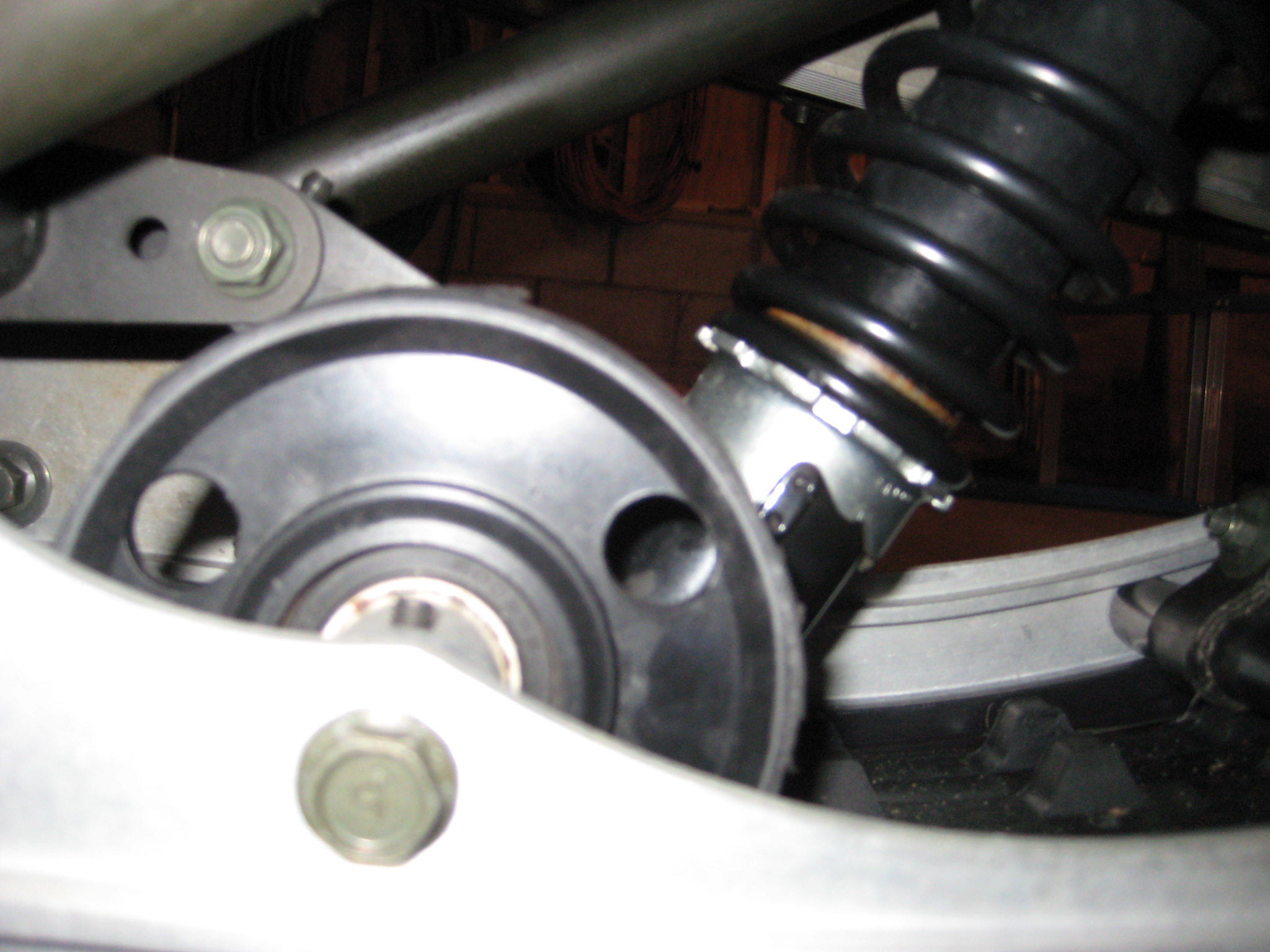

Thanks gents. I'm pretty sure all of the parts on the machine are stock. It appears that I need to replace item #18 in the attached parts diagram. The other crappy pictures are the result of 3 days of trying to talk my non-tech savvy parents through photo taking 101 (sigh). Obviously not the best pics, but hopefully gives an idea. The incredibly blurry photo shows how the rubber is pretty much gone.
Looks like these wheels can be had for $80 each from Yamaha, or $59 from www.powersedge.com . Not sure if there's any difference in the wheels to justify the added expense from Yamaha (maybe the replaceable bearings as Irv describes?).
Any tips for completing the work? I assume I'll need to at least loosen the track? Other than that, how are these things held in place?

you can pic up some yammy wheels with a 6005 bearinf in them. Yamaha wants so much for those wheels because they come with a new aluminum mount also... not required if in good shape. On my RTX i repalce these inner wheels yearly... yes they blow apart. last i bought them they were like $30 a wheel. in this location, the suspension has to be removed as the wheels are mounted on the main cross shaft that holds the front shock with spring.

Aren't those just regular accessory wheels? Port Yamaha has them for $19 to $20 bucks with the bearing.

I personally would go with the Excell wheels, they're priced right, are slightly larger, have a changable bearing and save your Hyfax.

Thanks again fellas. Canoehead, I did some research on your suggestion of the Excell wheels. Mostly positive feedback, but there was some concern over bending the rails with the larger wheels. Hopefully that's an unfounded fear - I see that Excell has a few thousand miles of testing on them. Overall they seem like a positive improvement so I'll probably order some up unless anyone has some last minute warnings about them. The Excell website does not list my RS Venture as a sled that these wheels will fit, but I just called them up and was told that they would, in fact, fit my Venture.

Just make sure they have a 6005 bearing....(its just in the center wheels) any other size WILL NOT fit. been there,... done that!
