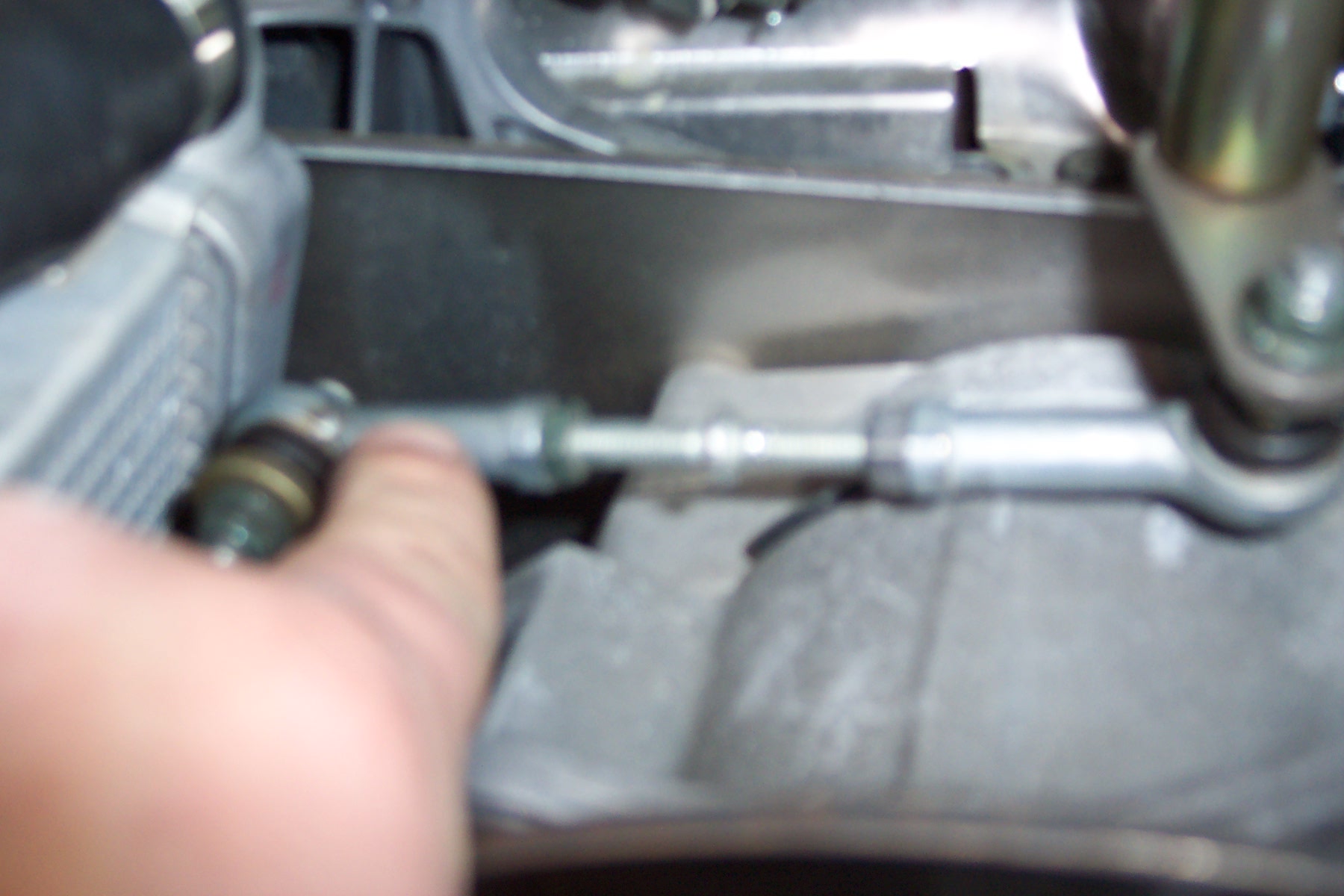

vmaxx05stud
well i dont know guys and im sure you think im a nut by now but there is no way that this 27mm is going to work as i got it close to 27 and couldnt even more the the handle and (w/track off ground) i put it in reverse and it still goes froward. the only thing i can think of is that someone(b4 me) had adjusted both upper and lower to the wrong set up.
the 2nd pic is where its set @1/1/2" to where i put it back to and now for some reason on the stand it works in reverse again(but w/ no pressure on it). 1st pic is the up and down rod which messures about 23/24 mm. does anyone know whatthe messurement should be as im trying to figure ifits been moved prior to me having the sled. thanks.
Tork
vmaxx05stud said:just back from my first ride after got code fixed and went to put it reverse and when it starts to back up it just grinds. any adjustment on this or is something wrong in side the gear box? doesnt have any problems forward and i used the reverse a couple of times today w/ no issues. thanks.
You need to go back to where you were! If it had been working but then one time it grinded, then you just happend to be tooth to tooth and it would not engage. (Once in a great while I get that. Put it back in forward, blip the throttle to move forward a couple of inches, then it goes into reverse perfectly)
One other thing you could try once you are back to where you were if it still aint right. try 1/8 inch longer than where you were originally, then try 1/8 inch shorter.
