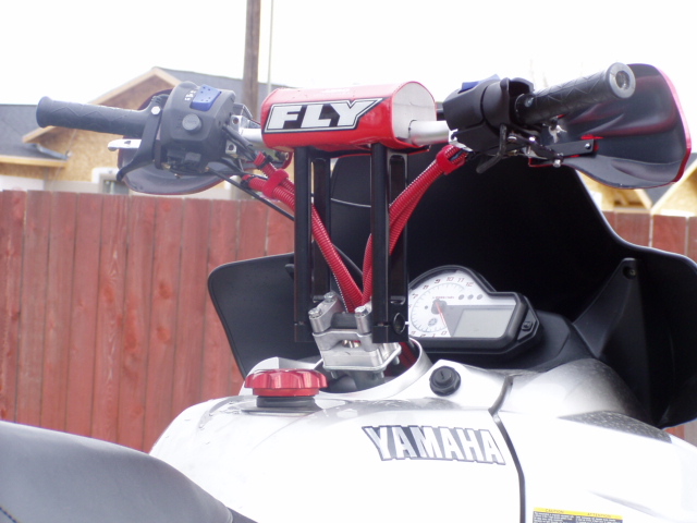

Aaron, I added fly bars and an 8" riser using MPI's long RX-1 cable and SLP's longer brake line. I also did a wire clean up using 3/8" red wire loom ans 5" long velcro wire ties to hold the loom together. I bought thr wire loom, velcro ties and heat shrink water proof wire connectors at Wal-Mart. Here are the pics I tooks of the bars after the wiring was all done.
Also, if you remove that rivet, you should beablr to get the slack you need for the stock cable. I used a pivot riser and had the bars pointed straight up. I went two years with no problems.
