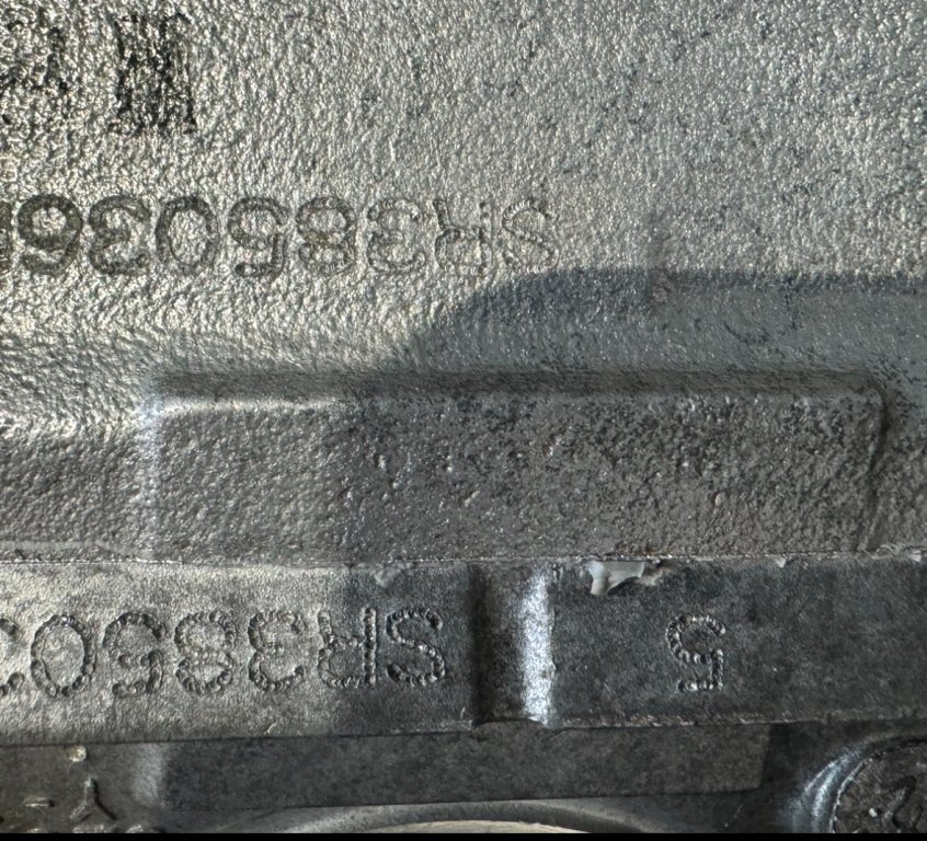

Hey guys I am having a weird yet similar issue finding bearings to use in my sled motor .. (swapped into a sxs ) I have the numbers on the crank to go off of yet I have zero numbers on the case to go off of.. am I looking on the right location ??
