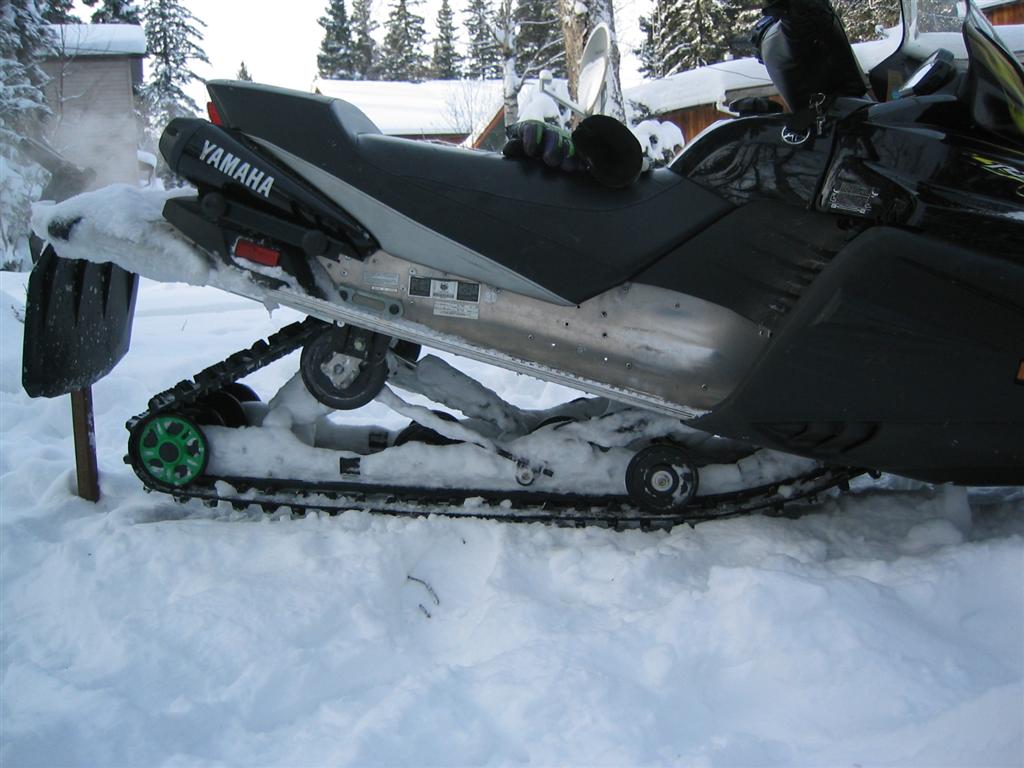

Cross Fire skid did the trick for me. I did it to decrease the approach angle and improve the ride.......it has done both very very well. Also lost 15+ pounds in the process (the sled, not me :tg: ). I'm still doing a bit of tuning, but I highly recommend this mod.
