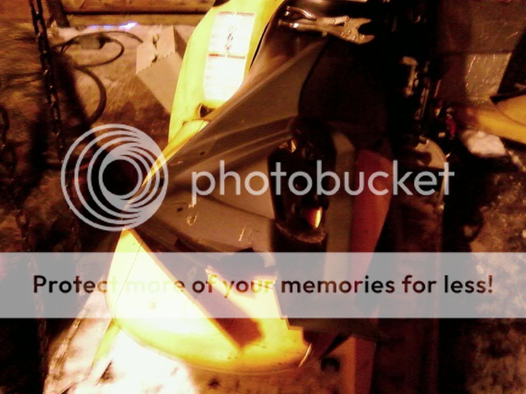

started pulling the sled apart yesterday and it looks like the BPE gauge pod has survived another roll over(the previous owner had a few crashes).
bars will be replaced if i cant bend them back to shape, the tunnel was pie to bend back, it looked like rivets were missing so i replaced them.
and i figured out why the oil light came on, a little bit of oil came out of the breather, and my air box was full of oil too.
got it all back together and heres pictures of the damage.
so hopefully tomorrow ill be able to get back in it for the first time in a week, but it depends on how im feeling cuz you know how it is with a really sore arm lol.

sorry for the quality guys, it was taken with my cell phone, you guys think the turbo should be fine? or is there anything i should be concerned about in a roll over?
