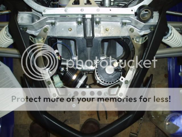

Not sure if these are clear enough to help or not. Make sure you have a good connection where you had to splice wire into stock harness.
I would like a pic of the oil tank side connection unplugged if its even supposed to unplug there. I'm not sure if I broke something or if I'm missing something. Thanks

Maddog said:I would like a pic of the oil tank side connection unplugged if its even supposed to unplug there. I'm not sure if I broke something or if I'm missing something. Thanks
Are you refering to the SC oil tank or the tank for the motor oil? Either way the there isn't a connection on the side. On the supercharger resevoir both temp sensors go on the bottom.
The one Srxspec has pictured above is the one designed to signal the OEM oil warning light which has a harness that plugs into the resevoir for the engine oil. The sensor designed to work with the OEM oil warning light is easy to break. MPI had a specific step in the instructions on how to tighten this to prevent damage.
If you have messed this up, your best bet might be to use a stand alone gauge in the drain plug hole and leave the stock oil level plug that goes to the engine oil resevoir plug directly into it which will bypass the harness designed for the OEM warning light. It might have been damaged prior to your install if you had the specific instructions and followed them (I have both sensor and they are good but I have lost my instructions and therefor am a little reluctant to remove that dainty (for lack of better terms) sensor Srxspec has pictured.

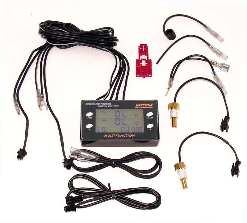

By the way; here is the guage I have. It is well worth the $259.95 + $39.95 for the water temp sending unit adapter IMHO. It has the blower oil temp, coolant temp, voltage, time and RPMs. It also keeps track of hours and has a data log for max RPMs. This is nice to have for figuring out you clutching.
Jim
