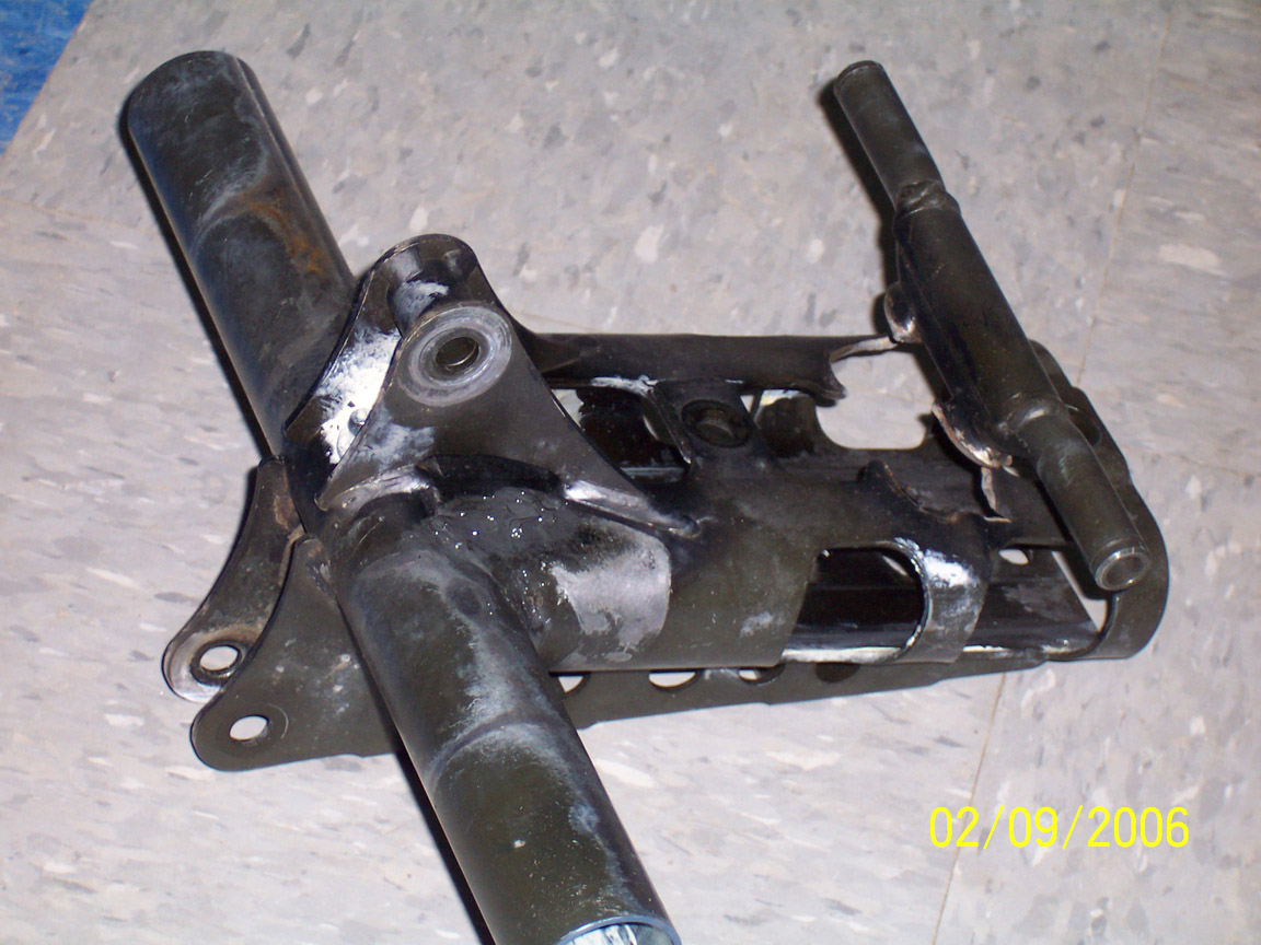

Went to my dealership today and took some photos of my broken Pivot Arm assembly.
My computer is acting up and I couldn't post the photos.
I have asked maddogjeff to post the photos for me. Hopefully he will be able to put them on tomorrow.
maddogjeff
- Mar 27, 2005
- 268
- 491
- Ride northern Vt & QC, live in Ct
Here are some pics Hondo took of his failed part (he had problems posting the pics himself). Nasty break, looks like it could just happen in one shot with no prior warning.

took my 'o5 Vector skid out for the 1st time this week. I was in SHOCK over the quality of the welds. Mediocre at best! Betcha $100 they're madein China or some other 3rd world country.
hondo
Thanks Maddogjeff for posting the pic's.
I also could not believe how flimsy the metal is, especially in an area that constantly takes a pounding, let alone the pressure from the spring tension.
This area definitely needs reinforcing!
aVenture and Towing certainly have the right idea.
