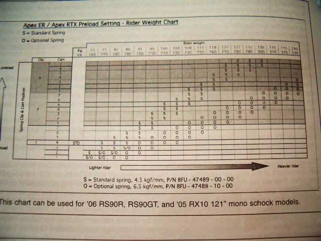

I have an '06 Apex RTX with the mono...I did the muffin works 136 tunnel and rail extension..I also went with a 1.5" lug....Sled defenately has more bite taking off...Ride very smooth..not choppy...I don't bottom out...When I had the skid out I pulled the shock and put the snap ring up in the 3rd position...with the spring pretensioner on its lowest setting it doesn't even come close to grounding out and me dressed I am about 245 lbs
I went with the 144 on my 08GT and love it. For the money you will be spending I would go 144.
Thanks Guys i think i am going to go with the 144" It is around the same money and i think it will ride much better. the only issue is it wont fit in a 10 foot enclosed trailer where as the 136 will. I have never heard about moving the snap ring on the shock id like to kow more about this. i am also about 245 geared up and sound like you have a good setup.
clip
Here are photos of the three clip positions on the monoshock and what weights it will handle at these weights
