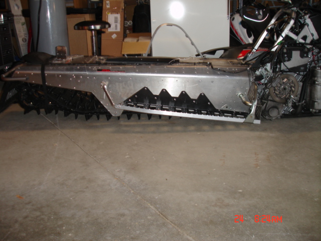

tylerj907
You can also special order thicker better boards. Regular one's are cut out of 1/8" and Rob said he has cut a few sets out of 3/16" for bigger riders. I just got done putting AC edges on mine and some custom fabbing on the better boards i already had. They seem pretty stiff and i can't wait to ride it!
