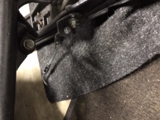

temp creeped up to 200 and yellow triangle came on. decent snow but a little warm 32 deg. i do have the heat exchangers under the foot rails. i have not installed ice scratchers yet. how do they make a machine that cant cool itself? do i really need a rear heat exchanger? looks like a pain to install and more money. whats with this thing? and yes coolant is 50/50
