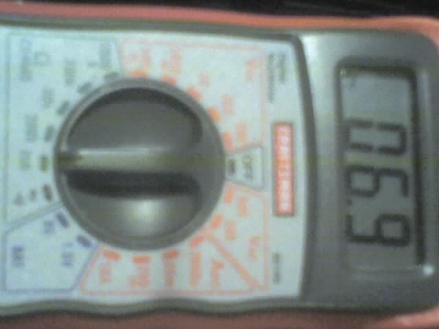

I got the 07 Apex handlebars with the "J" hooks. I want to put them on my 05 RX-1. A dealer told me not to do it because the hand warmers are different and I'll burn the CDI.
I put an ohm meter ( set @ 200 ) on the stock hand warmers and got a reading of 1.9. I put the meter on the Apex warmers and it read 6.9. Thats a big difference. Is there anything that can be changed on the RX-1 that will make this work?

The Apex bars won't burn out your CDI. Provided they are wired properly.
They are a lighter load (less current), which also means they won't be as warm.
They will need to be wired in parallel with each other, so your total resistance will be approximately 3.5 ohms. (Resistance will be half when they are wired in parallel.)
(I am assuming you were only measuring one of the handwarmers.)
If you wire them in series with each other, the total resistance will be approx double what they are individually, and the wattage (heat) will be half.
Less resistance = more power (heat)

FYI rcp1018 & I talked on the phone.
His existing bars were 1.9 ohms each and were wired in series for a total of 3.8 ohms.
His Apex bars had 6.9 ohms each and he is wiring them in parallel for a total resistance of ~3.5 ohms.
That is within 10%, easily enough for the computer to handle.
(He will actually get about a 10% increase in wattage, but with the longer heaters (more surface area) the heated feel should be about the same.
The 2005 RX-1 bars I have measured 2.0 ohms each, wired in series they total 4.0 ohms.
(about the same as rcp1018's)
The updated apex bars with the heated J hooks that I have measured 6.9 ohms each also.
I will also be wiring these in parallel.
