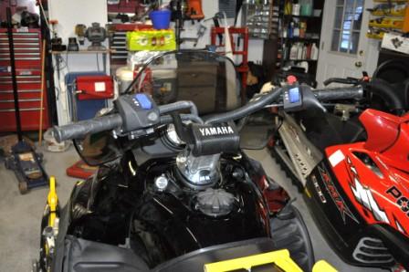

The 2nd pic is an 05 with stock bars and 6" riser from attack the 1st is an 03 mountain with an old set of pro taper bars i Believe they were.
