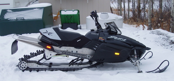

Monster Max
If you are interested I have a rx1 skid with 300km on it as well as a specialty sled tunnel extension that I want to get rid off.
I will find a pic.
I will find a pic.
Monster Max
NicSal
Nice sled monster max whats the price your askin for that skid and tunnel extention ??????
Monster Max
Its set for a 162. The brackets are from MPI, I machined a step into the to fit a 16 wide track. It also has a transfer kit in it.
It don't know about a price, make me an offer.
It will come with stock boggies not the billet ones.
