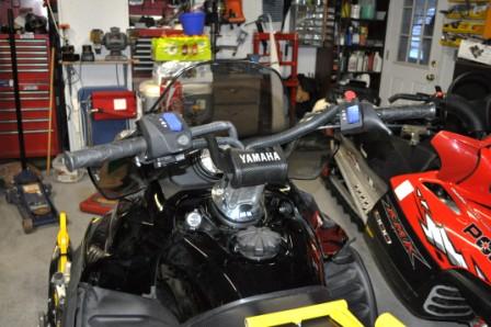

If you are staying with the stock bars, you can go with a 3.5" riser without changing any cable but you may have to re route the throttle and parking brake.HartleRacing said:thanks for the links, they were very helpful!
how high can i raise the bars without stretching the cables for throttle and such? looking to get a 2-3.5 inch bar riser to go with the seat.
You need the Yamaheater to install the bars because the wiring is different. You can get about 2" of rise in the bars untill you need to go to mountain cables and break line. The seat swap is easy.
I love this set up I can bounce from sitting to standing with no stress. I have mad the steering post re-location changes on other sleds to make them like the Apex but I do not like the feel. There are times on long runs I want to sit back and fly.
