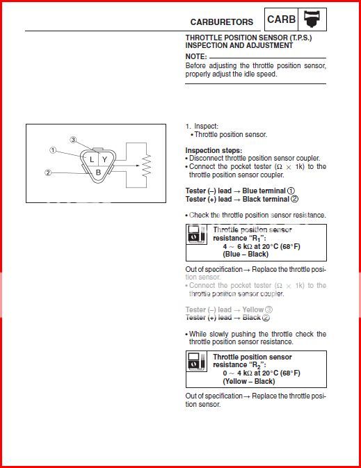

That's the TPS code ( throttle position sensor).
stomper
Yeah thats what I figured according to my service manual. So I did the tests that you posted and everything checked out good. So thats why I'm confused and thinking it's a some kind of freezing issue
