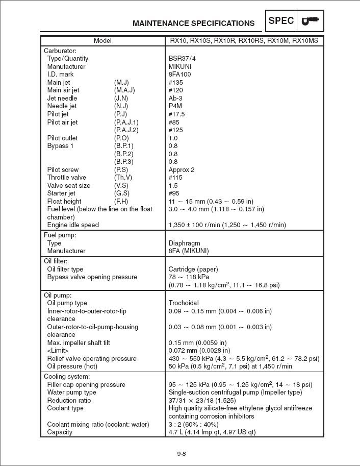

does anyone know how the 03 rx1 mountain comes from the factory? i am riding a factory 03 mountain at 600 feet above sea level.
4-play
My shop manual says, main jet 135, needle jet p4m, pilot jet 17.5.
Have fun,
4 play.

looks like they come from the factory the same as the regular rx1 with 135 mains. what is p4m?
thanks
thanks
4-play
P4m is the needle jet, that the jet needle, AB-3 slides up and down in when the carb slide (yamaha calls it a piston valve) goes up and down.

great info thanks, i just got a service manual.
