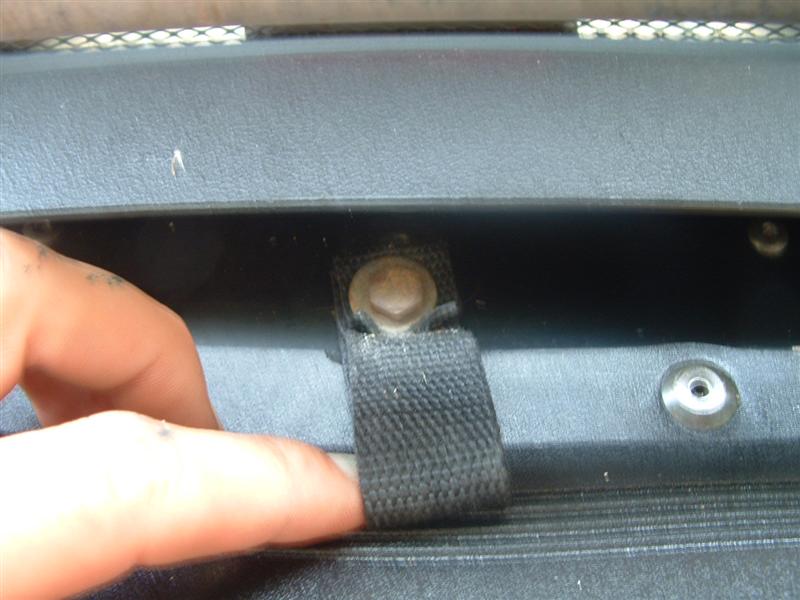

You've probably already installed your saddle bag but here is what I did with my RX-1. I used a fairly strong bolt with washers on both sides to hold the tab in place.
