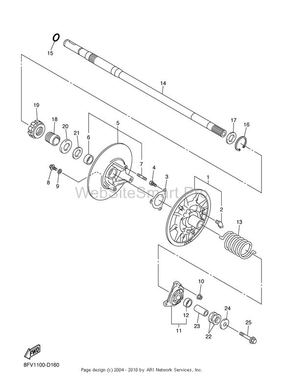

andrew1984 Extreme Joined Dec 27, 2010 Messages 117 Reaction score 0 Points 76 Location Woodbridge, Ontario Jan 21, 2011 #1 movement inward and outward is normal for the secondary. but is it normal for the unit to rock up, down and side to side? if not, how do you remedy this? is there a bearing right in there? daver Veteran Joined Sep 16, 2007 Messages 27 Reaction score 0 Points 281 Location Barrie, ON Canada Jan 21, 2011 #2 secondary slop bushing replacement 2 bushings, SKU: 90384-38243-00 on the diagram its 6 and 12. good luck Daver Attachments SECONDARY_SHEAVE.jpg 40.7 KB · Views: 113 andrew1984 Extreme Joined Dec 27, 2010 Messages 117 Reaction score 0 Points 76 Location Woodbridge, Ontario Jan 22, 2011 #3 thanks! royal distributing or oem? You must log in or register to reply here. Similar threads secondary clutch play T-Bone Jul 9, 2010 Apex General Talk Replies 3 Views 1K Jul 10, 2010 T-Bone stupid question..Movement between secondary and track??? Apex18 Dec 3, 2007 Apex General Talk Replies 2 Views 606 Dec 3, 2007 Apex18 secondary clutch play leepster Nov 7, 2007 Apex General Talk Replies 3 Views 1K Nov 7, 2007 1CrazySledder 6 Is this normal? Movement in secondary 600 Dec 20, 2007 Apex General Talk Replies 3 Views 880 Dec 20, 2007 nate007 Secondary sheave play msatow Mar 5, 2006 Apex General Talk Replies 1 Views 786 Mar 5, 2006 Len Todd Share: Facebook Bluesky LinkedIn Reddit Pinterest Tumblr WhatsApp Email Share Link
