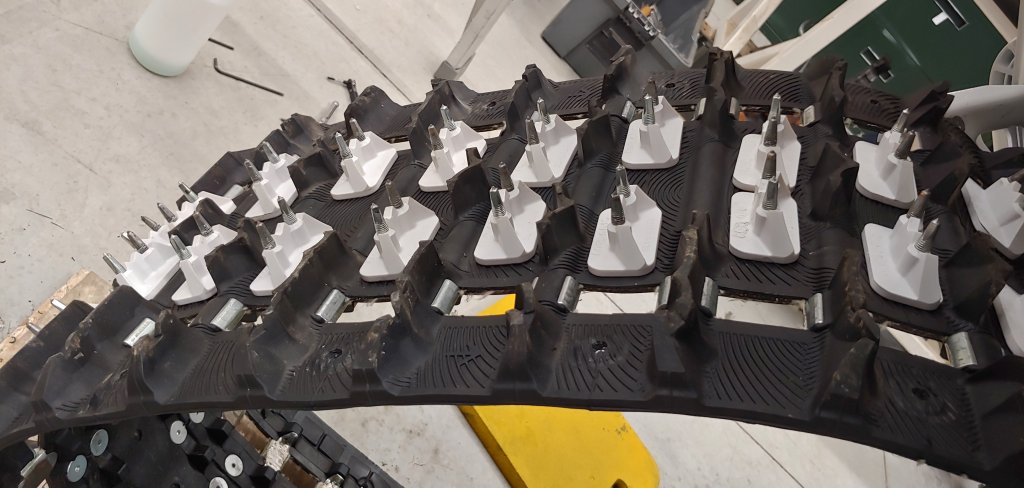

So a trick is to cut the hole small
So it’s hard to get the stud through even if you have to thread it through
I used to run a lot of studs but with angled backers and longer and less haven’t had any issues
You have to be mindful how to drive also
If you want to be always hard on the throttle then this setup doesn’t work and you will not really have traction
Getting transfer blocks set correct is a big deal
Pulling limiters will take away transfer and you need it
Just some fine tuning involved but it works

After very careful consideration, I've decided to go with 1.63" studs & Woody's angled backers.
Hoping this gives me the leverage needed to solve a good percentage of my traction issues.
I'm hopeful to just go with the 144 I've already set up for. And if needed I can go to the outside windows for another 48.
To recoup some of the expenses, I'll put my 288 studs & things on marketplace.
Thanks, guy. As always I'll let you know how it goes.

Can you use doubles in center
Doc Harley
- Oct 17, 2016
- 3,878
- 1,908
- 1,503
- Here & there
- '17 Sidewinder LTX SE
Using old 144 (single) pattern I had. Leave a lot of open holes. Lol.Can you use doubles in center

Keep an eye on the angled backers. I bought a 2015 MPI Turbo Viper in late 2018 with only 46 miles on it that had those backers with 144- 1.575 Mega-bite studs. I rwn them for a bit but removed those backers in favor of the scooped Stud Boy Super-Lite plastic backers. There were a number of the angled backers that were bent.
On loose snow you can't beat the scooped Super-Lite backers.

We have thousands of miles on them but run doubles in the middle
Jt is just using his old drill holes
No issues
I just shared our secret to hooking up
Long studs less number of them
The scoops work too
Stud bends wrong way under load
With angled it stands up like your ones in the picture
You cannot ride the sled like you stole it though and there is extra care to be taken
I personally wouldn’t run a stud shorter than a 1.63 in a one inch track
A lot easier to dial in not spinning
I run half the number of studs as your track with 300 hp tcat
No issues
The scoops work too

Yes maybe that works with angled backers. But no way with standard backers.. They will lay over and bend like crazyI personally wouldn’t run a stud shorter than a 1.63 in a one inch track

All the cats we’ve done this in
That’s how my poo is set up
The outside has straight backers
Middle angled
I check for bends every day and change accordingly
It’s not for everyone but it’s a disease that some of us snowmobile folk have! You never know when you may have to line em up
Lol
You can see in pic outside is standard
Middle angled
Lol

No i understand what your saying and don't doubt that length works with ANGLED backers.. I think its important to realize that we have lots of members on here that either don't want to spend time inspecting track every day riding and are not experienced enough for this aggressive of studding for trail riding. When we talk about running a 1.63 stud in a 1" track and someone that's just browsing here and sees this and thinks its okay to do.. That's a issue IMO.. Racing guys get it but very few are racing on this site. Your posting your draggy times and recommending stud lengths that are far to aggressive for 90% of guys on this site.. Im not trying to say it does not work but just pointing it out for many that will read this "semi hard pack/hard pack hook up"All the cats we’ve done this in
