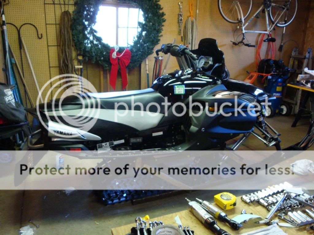

I have a couple questions regarding the use of a sled lift on an Apex and RX1. Where exactly are the lift points? Pictures I have seen look like the front support may interfere with oil changing? Is the rear support the running boards?

it will not interfer with the oil change, you just have to remove the side panels first and the belly protector if you have one.

I also put soft pine strips between the back lift legs and the heat exchangers.

I do the same thing with the wood. It also helps keep it level.

I have one from Eazy move carts..good customer service.
I agree with the posters above about positioning it.
The rear arms do ride on the running board coolers.
I've used it many many times and have no issues.

I'm Canadian so I used 2 hockey pucks on each side for the rear to cushion it on the running board/exchanger. Pine works great as well but sometimes the wood splits when your drilling thru it. i just recessed the bolt heads so that it doesn't make any contact with the running board

sgauthier said:I'm Canadian so I used 2 hockey pucks on each side for the rear to cushion it on the running board/exchanger. Pine works great as well but sometimes the wood splits when your drilling thru it. i just recessed the bolt heads so that it doesn't make any contact with the running board

Curious, how may guys start their sleds on their lifts?
I did yesterday for the first time and it seemed to work good.
I was nervous of doing this previously, but I didn't want to go through the hassle yesterday of lowering the sled etc, so I gave it a try.

i start my Apex on the stand but the SRX i need it lowered so i can pull that silly cord. if i don't it just moves all over the place.

sgauthier said:i start my Apex on the stand but the SRX i need it lowered so i can pull that silly cord. if i don't it just moves all over the place.
I was surprised how little mine moved when I started it and spun the track.
I was afraid the rear might move enough to jar those uprights loose that go under the heat exchangers.
It's not something I plan on doing all the time, but it is noce knowing I can without worry.
