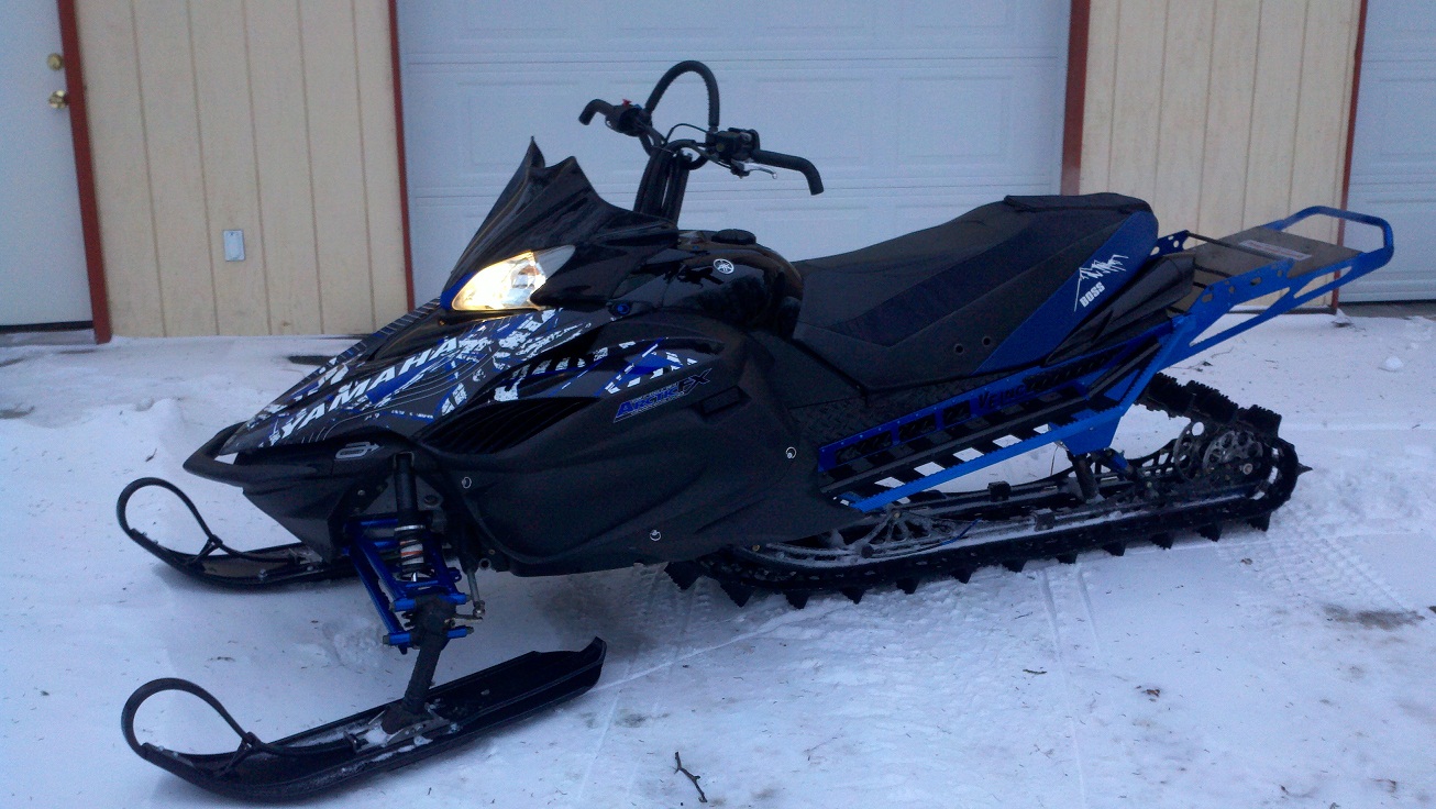

My new to me Apex MTX came with the stock mountain skis. Looks like he has good aftermarket carbides on there, not sure which ones. I could shim them a bit and try them out. Thoughts?
Another option is I have the 7" Slydog Powderhounds in my garage that I took off my Viper Mtn that I sold. Anyone running this set up?
I'm thinking about putting the Powderhounds on there, but I thought I'd first ask the group.
Thx all
