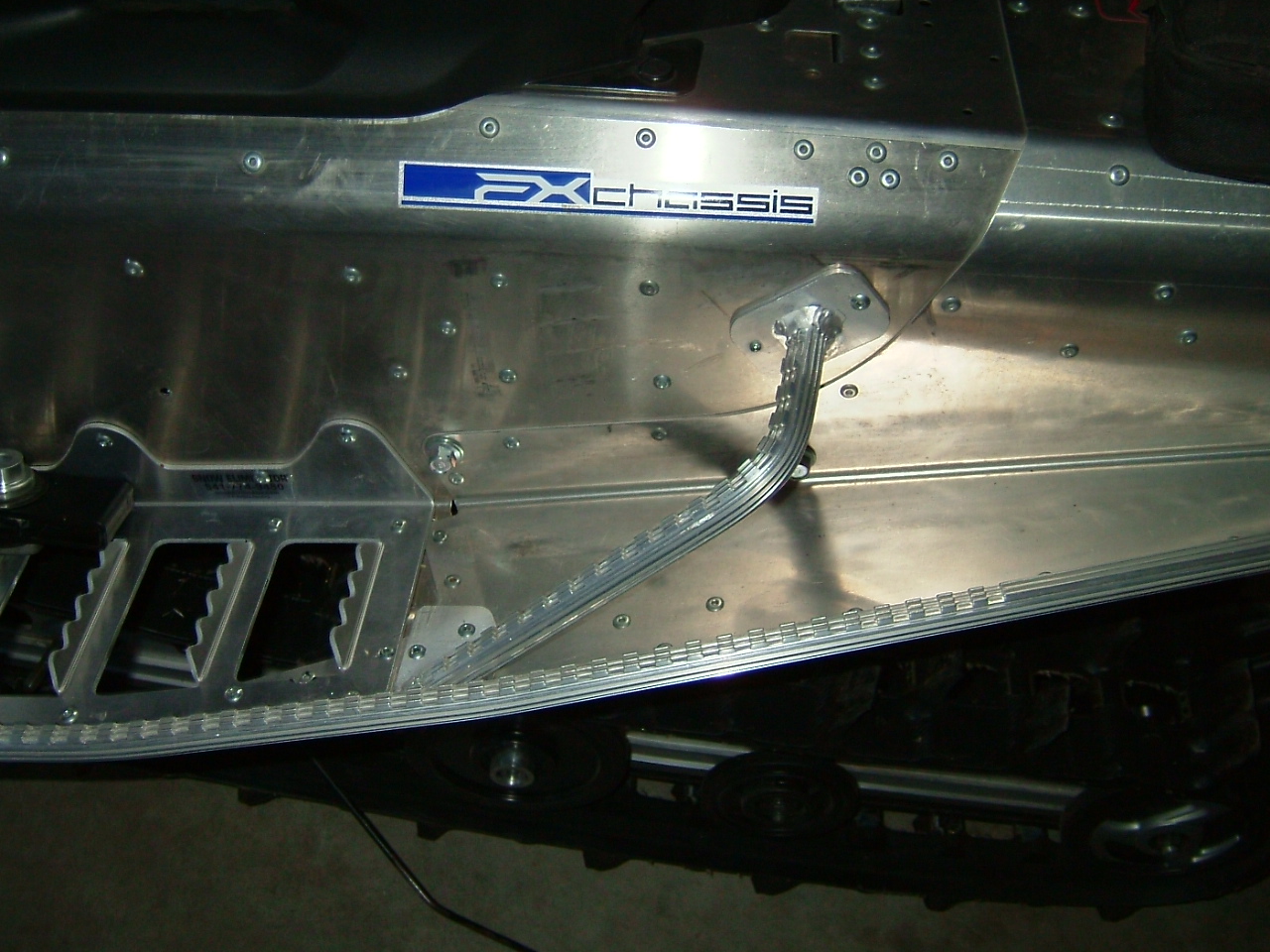

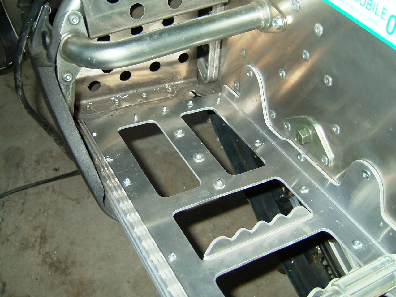

Here are a few ideas I came up with for added traction/support for the running boards after snow eliminator install.
Edit: You need to be careful and segment bend the aluminum extrusion because you can break it by trying to bend tomuch in one spot)
