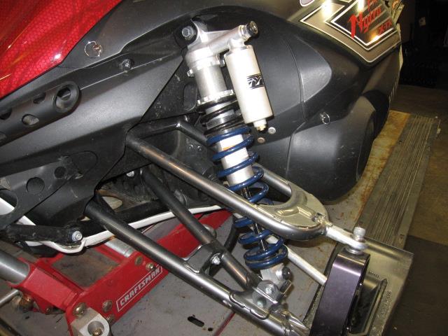

Adding PC5, Ignition Box and Auto Tune to my XTX, Added Hygear Dual Rate Springs, removing the Ice Ripper 144 and changing to a 1 3/4 Back Country... Here are a few photos of my progress.
I also extend my rails back to try and stop some of the snow dust kick.... my back and azz gets wet from all the snow dust beyond the boards. I also have to get my ski mounted scratchers installed.
I also changed drivers to the Apex Extroverts and axle. Had to move the drives just a bit to get them to be right on to my stockers...

Awesome! I can't wait for the snow.
you'll love the dual rates. that what i ran last year racing.

mewaschuk said:you'll love the dual rates. that what i ran last year racing.
How did you set your preload or your set ins?

Few more updates:
Grind off 5mm from rail tips to prevent extroverts from hitting the rail tips.
Install, O2 Sensor, PCV, Autotune and Ignition Module.

Did you have to cut 3/8" off the rails to keep from hitting the extros or did you only do the 5mm grind off? The only solution I had heard at this point is to actually cut the rails 3/8". I am about to install some extros from a 11' rtx into my 09' xtx

I was told that you only need 5 mm to use Yamaha drivers other drivers may need more.

MrSled said:I was told that you only need 5 mm to use Yamaha drivers other drivers may need more.
Okay good to know! I may just be on the safe side and take plenty! haha

Since you mentioned grinding the front of the rails, does anyone that's running 9t doo drivers had to do this as well?
